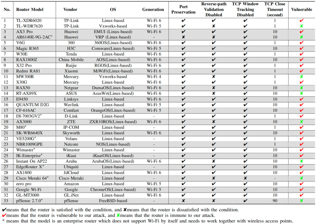

We conducted tests on 67 mainstream routers from 30 different manufacturers, including 360, Aruba, ASUS, Amazon, Cisco Meraki, China Mobile, Comfast, D-Link, GL.iNet, Google, H3C, Huawei, IP-COM, iKuai, JdCloud, Linksys, Mercury, Netgear, Netcore, Ruijie, Skyworth, Tenda, TP-Link, Ubiquiti, Volans, Wavlink, WiMaster, Xiaomi, ZTE, pfSense, and others. Among these, we found that 52 routers from 24 manufacturers were susceptible to this attack. The test results are illustrated inTable 1.
Table 1 — Partially tested routers from 30 vendors.
Additionally, we conducted measurement studies on 93 real-world Wi-Fi networks and found that 75 (81%) of them were susceptible to this attack. Our case studies indicate that terminating SSH connections, downloading private files from FTP servers, and injecting false HTTP response packets on average took 17.5, 19.4, and 54.5 seconds, respectively, with success rates of 87.4%, 82.6%, and 76.1%. The detailed experimental results are shown in the paper.
