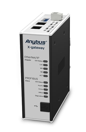

Through the gateway
A device such as the Anybus X-Gateway AB7832-F is typically used in an industrial environment, usually located in closed cabinets in restricted areas, which reduces the likelihood of unauthorized physical access.
This particular model translates between Для просмотра ссылки Войди
Therefore, it is supposed to be connected to an IP network in an industrial system so that it can be configured and do what is needed: establish a link between devices that don’t speak the same language. In a perfect world, the gateway is reachable on the network only by authorized users and devices from restricted OT locations, but do we live in a perfect world?
To test our gateway, we mainly considered the scenario where an attacker can reach the gateway on the IP network, without physical access to it. This could happen, for instance, if the attacker is located on the OT network with direct access to the gateway or has managed to reach it from the IT network or from the Internet.
